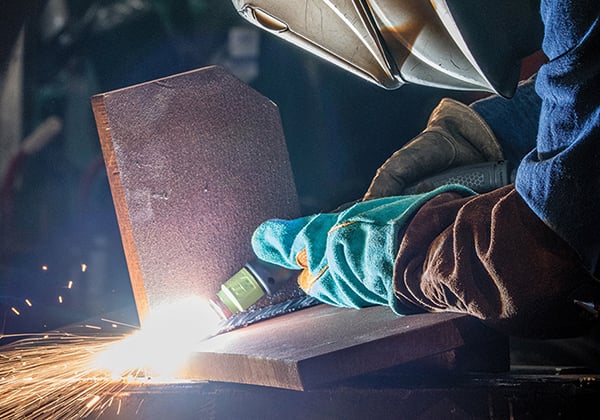

A plasma cutter or plasma cutting system uses a plasma stream to transfer energy to a conductive work material. The plasma stream is typically formed by forcing a gas such as nitrogen, oxygen, argon – or even air – through a narrow nozzle. An electric current produced by an external power supply adds sufficient energy to the gas flow to ionize it, turning it into a plasma arc. Therefore, the process is often called plasma arc cutting. The plasma arc cuts the workpiece by first melting it, and then blowing away the molten metal. Plasma cutting is suitable for a wide variety of applications, such as straight cutting, bevel cutting, gouging, hole cutting, fine feature cutting and marking. You can learn more about plasma cutting here on our ‘Plasma cutter technology’ page.

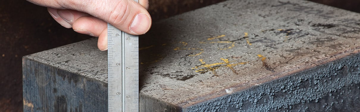

Metal thickness
Plasma torches can typically cut up to 2 inches of metal
Plasma torches are typically used for metals up to 2 inches thick, although plasma can cut material up to 6 inches in thickness. In addition, plasma can cut thinner metals faster than oxyfuel torches while causing little to no metal deformation. Oxyfuel is more often used for cutting thicker carbon between 2 and 12 inches.
