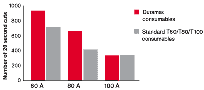

More consumable life
Conical Flow™ nozzle and Spring electrode give you up to 30% reduction in consumable costs over T-style torches*
