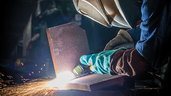

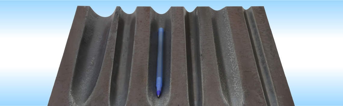

Benefits of Plasma Arc Gouging Over Carbon Arc Gouging
Achieve consistent and cleaner gouges, reduce the need for dangerous secondary grinding operations, and get better results by switching to plasma gouging.
plasma gouges with less noise and fumes
Plasma Gouges with Lower Noise and Fume Emissions
In many cases, plasma gouging is 5 to 10 decibels quieter. With less dust produced, it reduces slip hazards. The sparks are not blown as far and burn out quickly, thereby reducing fire hazards. Carbon arc gouging is noisier and generates potentially hazardous smoke and fumes, posing a risk to workers.
This often makes plasma gouging a safer and more environmentally friendly choice for indoors or confined workspaces.

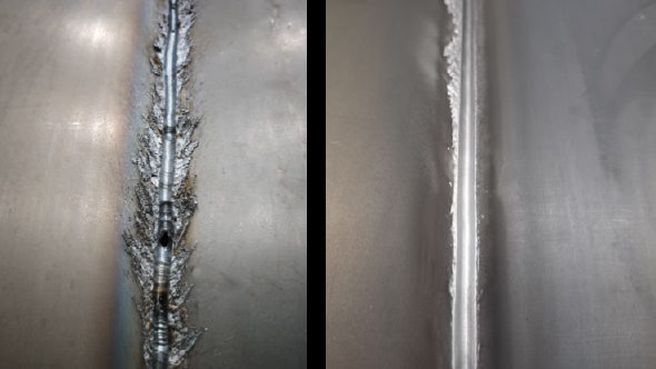

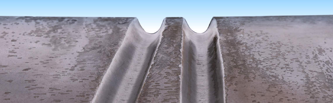

Plasma Gouges Can Be More Precise and Cleaner
Plasma gouging can produce, especially in automated applications, a more controlled contour, resulting in less post-processing work such as grinding. Carbon arc gouging leaves slag that is very difficult to remove.
The precision of plasma gouging helps improve workflow efficiency and reduces labor costs.
plasma gouging produces cleaner edges

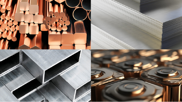

Plasma Gouges a Greater Range of Materials
Plasma arc gouging is effective on a wide range of metals, including abrasion-resistant steel, stainless steel, aluminum, and other non-ferrous metals. Carbon arc gouging is not effective on non-ferrous materials.
This versatility makes plasma gouging ideal for industries working with diverse metal types.
plasma gouging is effective on a variety of metals

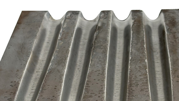

Hypertherm Plasma Gouging Solutions
Plasma arc gouging is a fast, precise way to remove metal—and it’s a game-changer in a variety of repair and fabrication tasks. Here’s how plasma arc gouging helps in some of the most common applications:
Back gouging with plasma ensures full weld penetration by removing material from the backside of a joint. Back gouging with plasma provides structural integrity, works great on thick materials, and is cleaner and faster than traditional grinding.
Weld removal with plasma arc gouging removes cracked or defective welds to prep for clean, substantial rework. Plasma delivers smooth, precise gouging for easy re-welding, less heat distortion than other methods, and improves repair quality and inspection readiness.
Riser and sprue removal of cast parts is something plasma arc gouging excels at. It quickly removes excess metal from cast parts without damaging the surface. Plasma gouging enables clean, controlled riser and sprue removal, is faster than grinding or machining, and protects part integrity for better finish and performance.
Hardfacing removal with plasma arc gouging strips away tough, wear-resistant coatings before repair or reapplication. Plasma gouging handles hard alloys with ease, reduces tool wear compared to mechanical methods, and speeds up prep time for re-hardfacing.

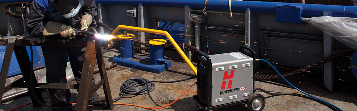

Powermax Systems – Versatile and Portable
The Powermax® family (Powermax45 SYNC, 65 SYNC, 85 SYNC, 105 SYNC, and 125) offers portable, air plasma systems that excel at both cutting and gouging.
  • Multiple gouging modes: Max Removal, Max Control, and Precision Gouging
  • Easily switch between cutting and gouging by changing the consumables
  • Perfect for field work thanks to rugged design and portability
  • Compatible with a wide range of torches and consumables, including Max Control, and Max Removal, for different applications
  • Watch Powermax gouging demo video

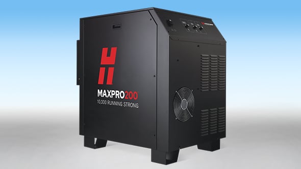

MAXPRO200
MAXPRO200 – Heavy-Duty Performance
The MAXPRO200® is built for high-capacity, industrial gouging and cutting. It’s ideal for applications that demand long duty cycles, deep gouging, and high productivity.
  • High amperage output (up to 200 A) for aggressive metal removal
  • Consistent arc quality for smooth, clean gouges
  • Durable and reliable in demanding environments like shipyards and heavy equipment repair
  • Watch MAXPRO200 gouging demo video

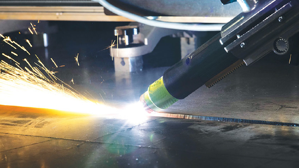

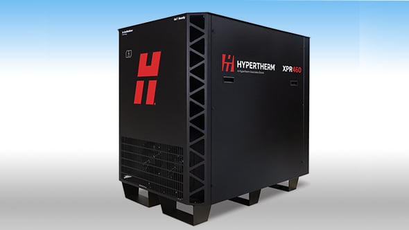

XPR – Redefining Weld Prep for Large-Scale Fabrication
XPR automated gouging delivers cleaner results, higher efficiency, and greater flexibility compared to traditional gouging methods.
  • Produces weld-ready parts with consistent gouge profiles, minimizing or eliminating post-process grinding
  • Enables automated gouging via robots, cobots, or guided systems, cutting labor and boosting throughput
  • Offers customizable gouge profiles across various materials and reaches difficult areas with enhanced arc stretch
  • Watch XPR gouging demo video
Enhanced XPR460
