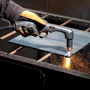

Manual or handheld cutting
In this mode, the torch or cutting head is manually controlled.  With a little training, the user can simply pick up the tool and start cutting.
Handheld cutting

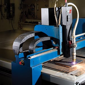

Automated cutting
Automated cutting uses software, electronics, or other programmable media to direct the cutting process. The object to be cut might be a metal part, piece of foam, stone countertop, pipe—practically anything. Typical examples of automated cutting systems include CNC cutting tables, pipe cutters, and industrial robots.
Automated cutting
