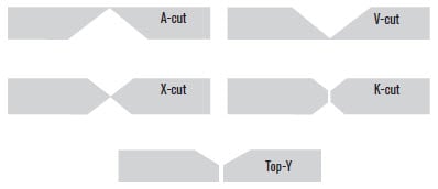

CAM software or CNC automatically applies True Bevel technology
Predetermined bevel angles, equations, and recommended sequences are applied to the job based on amperage and material thickness.
Predetermined cuts with True Bevel technologyCut styles include:
  • A-cut
  • V-cut
  • X-cut
  • K-cut
  • Y-top
