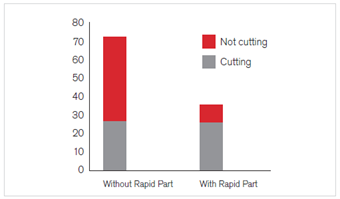

Reduce total production time by half
Bar graph production reduction
In this example, non-cutting time (red) is reduced by 80%, lowering the overall production time by 50%.
Note: Testing based on 20.3 cm [8”] flange parts with eight holes each, mild steel, 3.97 mm [5/32”] thickness.
