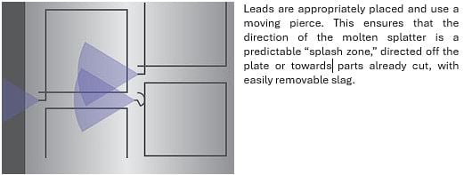

Plate Saver™ introduces new specialty leads to the CAM software when programming jobs for machines equipped with XPR®. It adjusts lead size, style, and location and uses a moving pierce to minimize part separations while at the same time maintaining part quality. The enhanced arc stability feature of XPR X-Definition® plasma quickly stabilizes the plasma torch arc, allowing for shorter lead lengths and closer part placement.

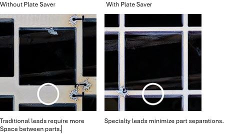

  • Minimizes part separation
    Utilizes a moving pierce to minimize part separations while maintaining part quality
Plate Saver minimizes part separations
Images with and without plate saver
Splash zone helps maintain cut quality
Splash Zone image

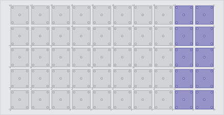

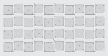

Nesting with square parts
Plate Saver is most effective when nesting square or rectangular parts. The below example shows square parts yielding a dramatic 14 percentage point improvement in true utilization rate:
Without Plate Saver
40 parts, 56% utilization

With Plate Saver
50 parts, 70% utilization
Plate saver image 70% utilization

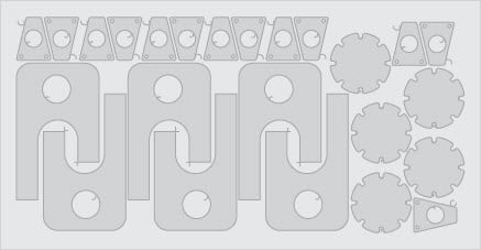

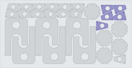

Nesting with mixed parts
Plate Saver yields an impressive three percentage point improvement on average for jobs containing a mix of differently shaped parts. This results in significantly lower annual material costs and cost-per-part—resulting in higher profitability.
Without Plate Saver
24 parts, 62% true utilization
Nesting image 62% utilization
With Plate Saver
29 parts, 65% true utilization
Nesting image 65% utilization
