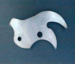

Small holes and intricate shapes such as slots, sharp corners, and tight radii present special problems for the plasma cutting machine operator. For our purposes, we will define a small hole as any hole whose diameter is less than 1.5 times the material thickness. Not only is it more difficult to cut these shapes cleanly with conventional systems, but reworking out-of-tolerance parts is more difficult as well – reaming out undersized or non-cylindrical holes and grinding into tight corners to remove dross isn't fun or cost effective.

The type and size of lead-in and lead-out can significantly affect cut quality, particularly with bolt-holes and slots. Two common defects are divots and bumps. A divot occurs when the arc removes too much material at the end of the cut. As the plasma arc crosses the lead-in kerf – the removed material from the beginning of the cut – it transfers to the saved part, causing a small indentation or, sometimes, a larger scooped-out region. This makes the hole out-of-round.
A bump occurs if the lead-in and lead-out do not adequately overlap. Some of the material in the hole is not completely removed, leaving a bump of uncut metal that prevents the hole from accepting a bolt.
Finding the appropriate lead-in and lead-out to minimize divots and bumps at start and end points can be challenging. Operators can use a trial-and-error process to find the appropriate combination. Generally, a radiused lead-in with a very small or negative lead-out (negative overburn) to the saved part will produce the best hole. Sometimes a short, straight lead-in works better with a small leadout (positive overburn).
