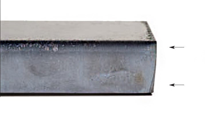

Bevel angle is the angle of the cut edge
A cut with 0° bevel is a straight cut, perpendicular to the plane of the material. Most plasma torches use a clockwise swirling flow of plasma gas, which produces a straighter cut on the right hand side of the kerf with respect to forward torch motion. Typical bevel angles for conventional plasma torches range from 1-3 degrees on the "good" side of the cut and 3-8 degrees on the "bad" side of the cut. High tolerance plasma cutting systems can achieve even lower bevel angles. Although some bevel is inherent in the plasma process due to the shape of the gas jet as it exits the torch nozzle, it is possible to minimize it. Bevel angle greater than 5 degrees may indicate a problem with PAC machine parameters.
