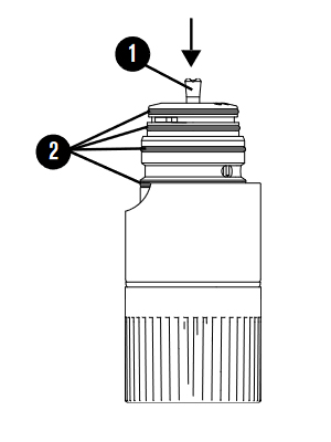

  1. Start with the water tube (1). Install a new water tube by inserting it into the torch and pushing until it comes to a stop. The water tube will move slightly to align with the electrode in the cartridge.
  2. Replace the four O-rings (2) on the front of the torch. Apply a thin layer of silicone lubricant to each O-ring before installation. Make sure that the O-rings look shiny, but that there is not too much lubricant.

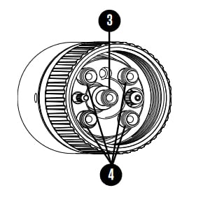

  3. Replace the single O-ring on the coolant-in connector (3). Apply a thin layer of silicone lubricant to each O-ring before installation. Make sure that the O-rings look shiny but do not have extra lubricant.
  4. Replace two O-rings on each of the four bullet connectors (4) located on the rear of the torch. Use pliers to pull the old bullet connectors straight out. Apply a thin layer of silicone lubricant to each O-ring before installation. Make sure that the O-rings look wet, but without excess lubricant.
  5. Install the new bullet connectors. Make sure that each bullet connector is fully installed, but do not use tools to push the bullet connectors into the slots. Tools can cause damage to the bullet connectors.

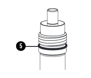

  6. ILL_HPRcartridge_3.jpgReplace the large O-ring on the HPRXD receptacle (5). Do not lubricate this O-ring. Unlike all the other O-rings we’ve discussed, this O-ring should not be lubricated. Remove the old O-ring and install the new O-ring. Make sure it is seated evenly.
