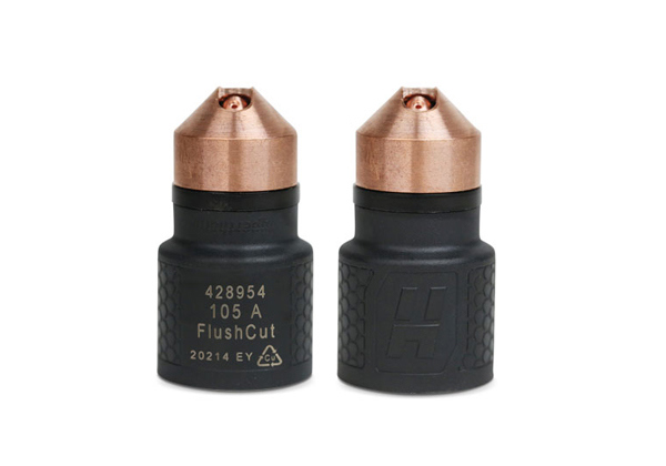

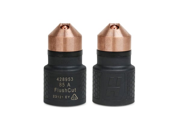

Benefits of Hypertherm FlushCut cartridges

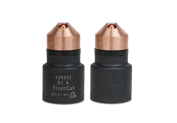

FlushCut consumable cartridges have been specifically designed to allow Powermax SYNC users to cut attachments, lugs, pad eyes, and other positive features as close to the base as possible without piercing or damaging the workpiece. The angled nozzle bore design and flat guiding shield enable flush cutting that leaves less than 5 mm (3/16 inch) residual material on the base or workpiece, reducing grinding and secondary repair operations.
The 45-degree angle of the FlushCut arc allows for lugs and attachments to be removed with a flat bottom, increasing the chances for the lug or attachment to be reused. The guiding flat on the shield helps operators avoid digging into the base plate, reducing the need for costly repairs.

Install the appropriate Flushcut cartridge into the SmartSYNC torch. FlushCut cartridges for Powermax SYNC systems are black. Once installed, the system will automatically set to the proper mode and amperage based on the cartridge type.
With the cartridge installed, align the flat side of the copper cartridge shield along the baseplate. Hold the torch approximately ¼ inch, or 6 mm, away and just off the edge of the attachment. If the shield is not aligned with the baseplate, loosen the cartridge and adjust it by turning the shield in the desired direction. Reinstall the cartridge and verify alignment again. Repeat if necessary to correctly position the shield for best results.
