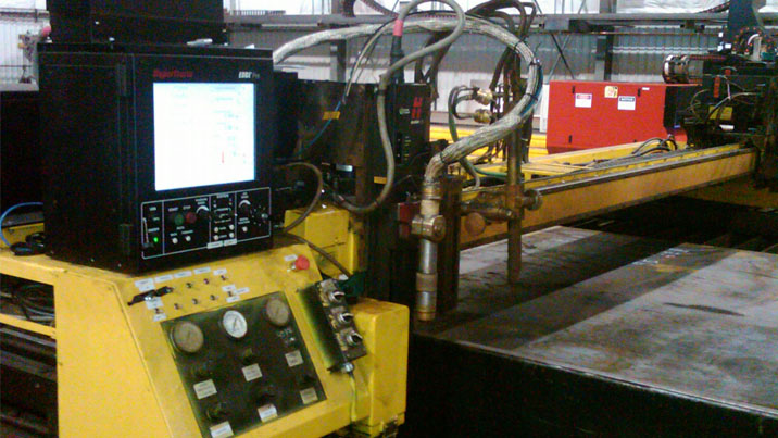

Outdated cutting equipment on one of the two 10' x 50' plasma cutting machines compounded the issue by limiting 95% of the high-volume production to just one machine. After A.J. Forsyth installed an HPR260® five years earlier, the old plasma system wasn’t used for plasma cutting again because customers would not accept the poor cut quality. The 15-year-old plasma and oxyfuel cutting machine could only be used for jobs that required oxyfuel.
“Our five-year-old HPR260 has been reliable and done well handling the workload. Once we installed the HPR260, the older system was instantly obsolete,” Handley said. “We decided we needed a second HyPerformance machine to increase productivity on the second table and help us keep up with demand.”

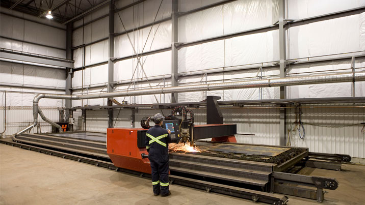

All components on the older cutting machine were removed and the system was stripped down to the gantry and rails. The HPR260 was moved to the revamped cutting machine. The retrofit included new drive motors, rack and pinion, gears, and the addition of an EDGE® Pro CNC and ArcGlide® THC. During integration, a new XD control board and firmware were installed in the HPR260 power supply, and a new XD torch and lead set completed the upgrade to an HPRXD with the latest technology.
A new HyPerformance HPR400XD® replaced the HPR260 on the high productivity table, with the retrofit completed over a weekend to minimize downtime. Handley explained, “Our customers preferred the high-definition cut quality of the HPR260; and as a result, this machine was in constant demand while our traditional plasma was underutilized. The HPR400XD installation was fast. We started on a Friday at shutdown, and we were cutting with it on Sunday.”

Handley explained, “We have more than doubled our productivity. Our order fulfillment is much faster because we have gone from one table booked for 116 hours of cutting time a week, to two tables booked for 232 hours, and the cut speeds have jumped from 400 inches per minute to 1,000 inches per minute.”
