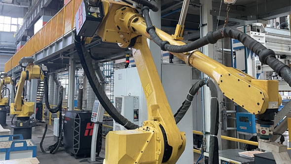

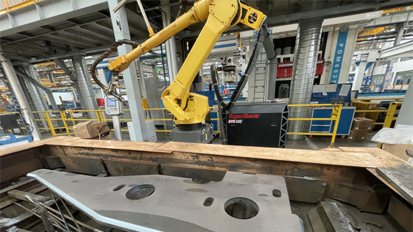

Solution: XPR300 plasma system increases beveling speed
After understanding the customer's needs, a key account manager and application engineer from Hypertherm Associates proposed a solution to transform the robot flame beveling process into robotic plasma beveling and recommended integrating the Hypertherm XPR300® plasma system.
Hypertherm's XPR300
The XPR300 represents a significant advancement in mechanized plasma cutting technology, redefining what plasma can do by expanding its capabilities and opportunities in ways never before possible. With unmatched cut quality on mild steel, stainless steel, and aluminum, the XPR300 increases cut speed, dramatically improves productivity, and slashes operating costs.
Ease-of-use features and system optimizations make the XPR300 easy to run with minimal operator intervention, lowering labor requirements while ensuring optimal performance and unmatched reliability. The system is designed with fewer consoles and easy connections, so operators spend less time setting up and more time cutting. The XPR system’s intuitive operation and automatic system monitoring redefine what simple and user-friendly plasma cutting means.
Ease-of-use features include:
EasyConnect™ torch lead and one hand torch-to-receptacle connection enable fast and easy change-outs.
QuickLock™ electrode delivers easy consumable replacement.
Full control of all functions and settings is available via the CNC.
Wi-Fi in the power supply enables multiple system monitoring and service from mobile devices.
Arc response technology™ provides automatic torch and ramp-down error protection, eliminating the impact of ramp down errors and reducing the impact of catastrophic electrode blowouts which can damage the torch – significantly extending the life of consumables.
Sensors in the power supply deliver refined diagnostic codes and significantly enhanced system monitoring information, reducing troubleshooting time and delivering proactive data to improve overall system optimization and uptime.
Business impact: Faster cutting speeds with minimal post-grinding operations
The coal company successfully transformed beveling operations by switching to plasma bevel cutting and integrating Hypertherm’s XPR300. Using the XPR300, the company has faster cutting speeds, no slagging issues, and minimal post-grinding operations. They have significantly improved production capacity and reduced cost-per-part.
At the same time, the company has increased the life of their consumables. While operating two, 10-hour shifts per day, they are experiencing an average consumable usage – electrodes and nozzles – of five shifts per consumable set.
