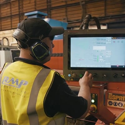

Intuitive controls and operation, together with automatic monitoring, make the system easy to use, even for new operators. Training is faster, and seasoned operators deliver better cut quality more efficiently. Full control of all functions and settings is available via the CNC, and automatic system monitoring and specific troubleshooting codes improve maintenance and service. Wi-Fi in the power supply connects to mobile devices and LAN for multiple system monitoring and service.

The cut quality is much better than the quality they had with their previous cutting machine, and the XPR300 is easier for operators to use. The controls are clear and easy to understand, with fewer buttons, so it’s also easier to learn how to use it.
