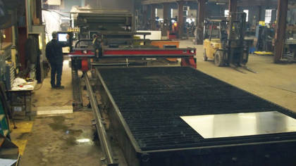

Quality Machine had been considering waterjet as an option for better cut quality, but concerns about the operating cost, garnet hassle, and higher maintenance costs led them to reconsider and explore recent advancements in plasma. They asked their cutting machine manufacturer to provide a solution that would include efficient nesting software, superior service, and greatly improved cut quality and productivity with precise motion.
Quality Machine chose a cutting machine with Hypertherm’s SureCut™ technology, including a HyPerformance® Plasma HPR400XD®, EDGE® Pro CNC, ArcGlide® THC, ProNest® software, and True Hole® technology.

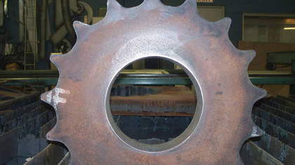

True Hole technology produces significantly better hole quality than what has been previously possible using plasma. True Hole is automatically applied by the nesting software or CNC software to thicknesses up to 25 mm (one inch). Diameter and hole coverage ranges from hole diameter to thickness ratios from 2:1 to as low as 1:1.
True Hole virtually eliminates hole taper, delivering true bolt-hole quality automatically, without operator intervention. Ding is reduced and biased to the outside of the hole. True Hole reduces the need for secondary processes and completes jobs in fewer steps, narrowing the gap with laser hole quality and making the plasma process suitable for many jobs previously cut with laser.

True Hole technology enables Quality Machine to use plasma cutting for hole cutting, increasing productivity and hole quality and reducing the need for drilling and punching.
Since the HPR400XD, EDGE Pro CNC, ArcGlide THC, ProNest software, and True Hole technology are all Hypertherm products developed to work together, the components work seamlessly and effectively as one system.
