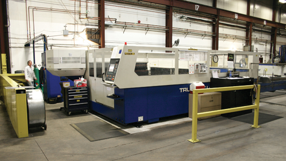

“There are so many ProNest features I really find fantastic and that we use; particularly for our lasers. ProNest’s Collision Avoidance option has been huge for us, especially for use on some of the older lasers where raising and lowering heads is slower. We can now traverse with the cutting head down versus a full retract between every pierce and that has translated to a savings of just over an hour of production time per day, per laser, which is awesome! We now see significantly reduced wear and tear on the laser machines; which reduces our costs.”

Collision Avoidance
Many machine operators are careful to keep away from tipped-up parts and other obstacles that might collide with the cutting head. Unfortunately, this can mean having the operator watch carefully over the whole process or cutting the entire nest with full head raises. These steps work to prevent collisions, but the process takes a long time to complete due to all the up-and-down motions.
With Collision Avoidance enabled, ProNest automatically adjusts leads, traverse paths, and the cut sequence to avoid possible head crashes right from the start. This allows for safe head-down motion and faster job completion.
Leads are repositioned so that the head is always moving away from the previously cut profile. This means the head is no longer in danger of colliding with previously cut parts or cut-outs that have tipped up.
Exterior leads are positioned closer to the next part in order to minimize traverse time.
The internal cut sequence within a part is optimized to best support collision avoidance and minimize traverse time.
Rapid traverse paths between cuts are routed around potential tip-ups, further reducing the chance of crashes.

Collision Avoidance has increased productivity as well, enabling the company to gain an additional hour of production time on each laser machine every day.
