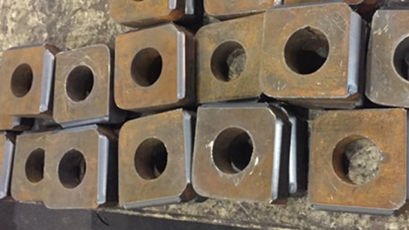

Challenge: Inefficient oxyfuel beveling could not meet production requirements
Due to high demand and increasing orders, the company’s robotic oxyfuel beveling process could no longer meet production requirements. Additionally, oxyfuel beveling required a significant amount of subsequent parts processing, leading to high operating costs. The company was also concerned about safety issues related to using oxyfuel cutting.

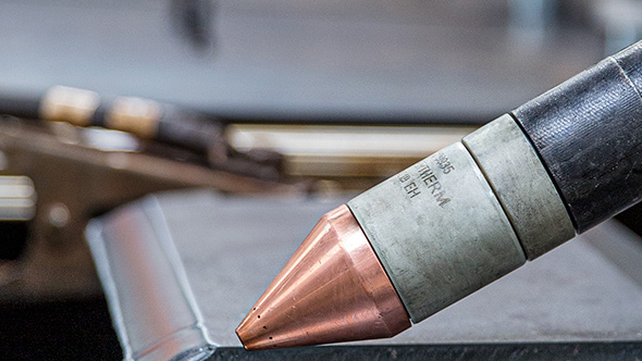

An application engineer from Hypertherm Associates conducted an in-depth assessment of the customer’s production workshop to understand the challenges and production requirements they were facing. Considering their specific circumstances, the engineer recommended upgrading the robotic oxyfuel beveling process to robotic plasma beveling and integrating Hypertherm Associate’s long-lasting MAXPRO200® plasma system.
The MAXPRO200 offers cutting and piercing speeds that are seven times faster than oxyfuel cutting, significantly improving production efficiency. Plasma cutting provides higher flexibility, allowing for the cutting of almost all metals, including low-carbon steel, stainless steel, and aluminum.
Compared to the highly flammable acetylene gas used in oxyfuel cutting, MAXPRO200 enhances the safety of low-carbon steel cutting.
The MAXPRO200
The MAXPRO200 plasma cutter is engineered for heavy-duty, high-capacity automated and handheld cutting and gouging applications. The system is easy to use and operates with either air, oxygen, or nitrogen plasma gas, combining fast cutting speeds and quick process changes to maximize productivity.
Optimized cutting parameters are automatically set and controlled in one step to deliver consistent results without operator intervention. Advanced diagnostics simplify troubleshooting, enabling faster resolution of any system issues. The MAXPRO200 also offers optional serial communications for full control of the system from the CNC.
Advanced Hypertherm consumable designs improve cut consistency and significantly increase consumable life, decreasing cost-per-part. Patented consumable designs enable best-in-class cut speeds and robust production piercing using lower amperage levels.
The MAXPRO200 has the fastest cut speeds in its class. Its automatic settings, tool free leads, and optional quick disconnect torches let you quickly transition between cutting, gouging, mechanized, and handheld processes. Superior cut quality and consistency minimize the need for costly secondary operations.
Business Impact: MAXPRO200 tripled cutting efficiency, delivered ROI in months
The construction machinery manufacturer fulfilled its objectives for the project, more than tripling bevel cutting efficiency using robotic plasma beveling in place of robotic oxyfuel beveling. The project achieved ROI within a year due to the MAXPRO200’s increased efficiency and better cut quality. The company decreased overall beveling costs up to 400% by switching from oxyfuel beveling to plasma beveling.
At the same time, the MAXPRO200’s superior cutting quality reduced subsequent grinding, improving workers’ productivity. Worker safety conditions also improved.
