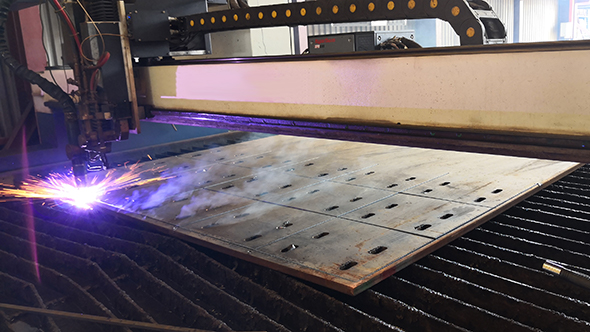

The company chose Hypertherm’s X-Definition® XPR300® plasma cutting system to significantly boost production processes without compromising on quality. They added True Hole® technology to easily fabricate bolt-ready holes down to a diameter-to-thickness ratio of 1:1.

True Hole technology
True Hole technology produces significantly better hole quality than what was previously possible using plasma. True Hole is automatically applied by the nesting software or CNC software to thicknesses up to 25 mm (one inch). Diameter and hole coverage range from hole diameter to thickness ratios from 2:1 to as low as 1:1.
True Hole technology benefits include:
True Hole delivers true bolt-hole quality automatically, without operator intervention.
True Hole narrows the gap with laser hole quality, making the plasma process suitable for many jobs previously cut with laser.
Hole taper is virtually eliminated.
Ding is reduced and biased to the outside of the hole.

The XPR300 with True Hole technology addresses MASI’s requirements for a cutting solution that can handle a variety of plate thicknesses – ranging from 4mm to 40mm – with various types of shape and hole cutting. Cut quality has improved. Switching to the XPR300 has also improved consumable life for MASI while reducing production times and material waste. This has allowed MASI to register cost savings of 10-20%, depending on material thickness.
