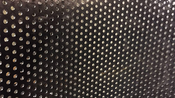

Mitchell Mill found this out in dramatic fashion when cutting a custom part for one of their customers. The customer required 7,000 holes in half-inch mild steel (pictured above). Doing this job with Mitchel Mill’s old software running their plasma system, the company was forced to ream every hole as a secondary process because of the amount of taper on the cuts.
Using ProNest LT’s more advanced cutting techniques, including variable feed rate and the ability to lock down torch height control, the holes now come out virtually taper-free, and Mitchel Mill has been able to eliminate secondary operations on almost all of their parts. Johnson explains, “The quality with ProNest LT is incredible compared to what we were getting before on the same cutting equipment.”
