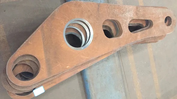

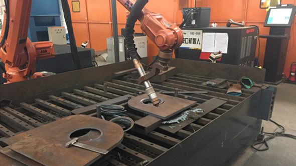

Challenge: Oxyfuel beveling fails production requirements
The machinery company has high-precision requirements for circular beveling and requires minimal thermal deformation (expansion with heat or contraction with cold). They were using robotic oxyfuel beveling, but that process failed to meet their production requirements for bevel quality and efficiency. The subsequent processing workload for beveled parts was substantial, leading to high costs. Safety was also a concern.

In response to their challenge and requirements, an application engineer from Hypertherm Associates recommended upgrading to Hypertherm’s HPR260XD high-performance plasma system. The HPRXD high-performance plasma series includes a high-rigidity cutting torch and cable designed specifically for robotic applications. The cable and cutting torch are available in various lengths, so they integrate easily into different robotic applications that are especially suitable for robotic bevel cutting.
The HPRXD series offers numerous advantages: faster cutting speed, shorter process cycles, quick process switching, and reliable and durable performance. By improving cutting capacity, the HPR260XD significantly reduces operating costs.

The machinery company fulfilled all of their beveling objectives by implementing the HPR260XD and switching to plasma bevel cutting. They significantly improved bevel quality and more than tripled cutting efficiency compared to robotic oxyfuel beveling. The HPR260XD’s superior cutting quality reduced the need for subsequent grinding, improving worker productivity and safety conditions.
The company reduced overall beveling costs by almost 400% by switching from oxyfuel to HPR260XD.
