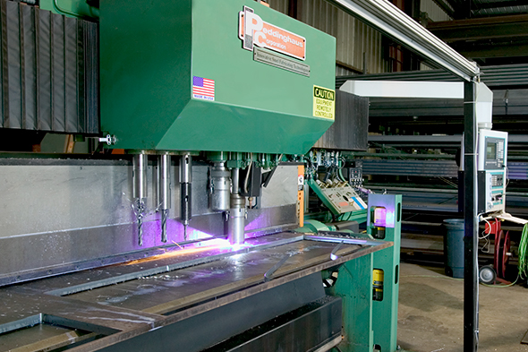

DenCol prides itself on outstanding service. To provide the best possible service to customers, DenCol features some of the most advanced profiling equipment available today, including an Amada® laser, two Peddinghaus FDB 2500 Plate machines, a Whitney punch plasma, and ESAB® plasma and oxyfuel machines.
With all those machine brands and cutting processes, the company found itself using numerous software programs supplied by the various machine producers – a situation that was far from ideal. Operators had to learn multiple programs, increasing time spent training.
