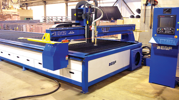

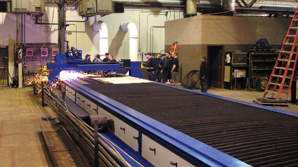

Before long, Craig Manufacturing’s new EBF plasma table arrived equipped with Hypertherm’s HPR400XD®, EDGE® Pro CNC, ArcGlide® THC, and programmed by ProNest.

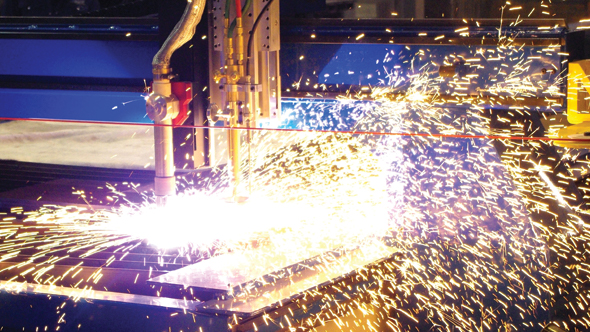

Cut quality has also improved. True Hole technology’s improved hole accuracy and quality have significantly reduced secondary grinding operations for the company, increasing productivity even further.
