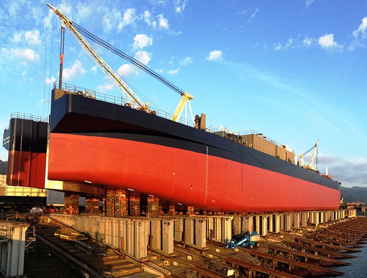

Operating from the largest side-launch shipyard on the West Coast of North America, Gunderson Marine is a deep-water facility, fully equipped for constructing all types of river and ocean-going barges. Gunderson Marine, now part of Oregon Green Manufacturing, LLC, operates a 58-acre industrial waterfront site in Portland, Oregon.
With up to 700 feet of capacity, the company is capable of producing large, ocean-going vessels and conventional deck barges for transporting aggregate, heavy equipment, and other industrial cargo. It has built thousands of marine vessels, including every type of barge imaginable – deck barges, dump scows, oil spill recovery vessels, crane barges, hopper barges, and numerous others.

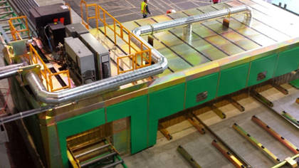

The company began its modernization efforts by adding three large CNC tables to its operation. The tables, equipped with Hypertherm HyPerformance Plasma, allowed Gunderson to significantly speed up cutting flat plate. In addition, the company replaced some of its oxyfuel hand torches with Hypertherm Powermax plasma systems.
The company's modernization efforts didn't end there. Though the three CNC plasma tables made cutting flat plate much more efficient, the company was still doing a lot of manual work. Gunderson searched for a solution that would allow it to cut the many three-dimensional shapes required when building barges, in addition to cutting flat plate.
"We researched quite a few machines, and narrowed it down to four or five before ultimately choosing a 900," Stokman says. "The winning thing for the 900 is that the robot is able to cut on all four sides of the steel, of the structure, so that was nice."
Gunderson chose the SteelPRO 900 made by lnovatech Engineering (now part of Lincoln Electric). It is a dual-purpose system offering both robotic beam line cutting and standard plate cutting. A Fanuc robot holding a Hypertherm HyPerformance Plasma torch can cut all around beams and tubing – along with structural shapes such as bulb flats (a long flat piece of steel with a short, tapered lip on one side), channels, and angles – while the table cuts flat, base, and stiffener plates.

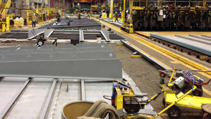

Stockman calls the system’s flexibility a huge benefit. "It has the plate table so when we're caught up, we can cut 2-D parts on our plate machine. If we need a rush part, we can just put that on the machine really quickly, or if there is an engineering change, we can quickly cut out a one-off part without interfering. It is very versatile. We can cut just about any shape we can dream up."
The shapes cut from mild steel range from ¼ to 1 inch thick. Once cut, Y-bevels and bolt-ready holes are quickly made using Hypertherm's SureCut technology. Stokman is impressed with the cut quality. “Cut quality is very good, great actually. It exceeds all the standards we need to adhere to. Holes are nice and round; everything's even.”
A job that used to take six people now takes one. Since Gunderson is running three shifts, the savings quickly multiply. This allows Gunderson to move more people downstream – onto welding for instance – helping speed up overall production. Stokman estimates that there are days when the company is putting more than 4,000 lineal feet of material through the lnovatech machine.
