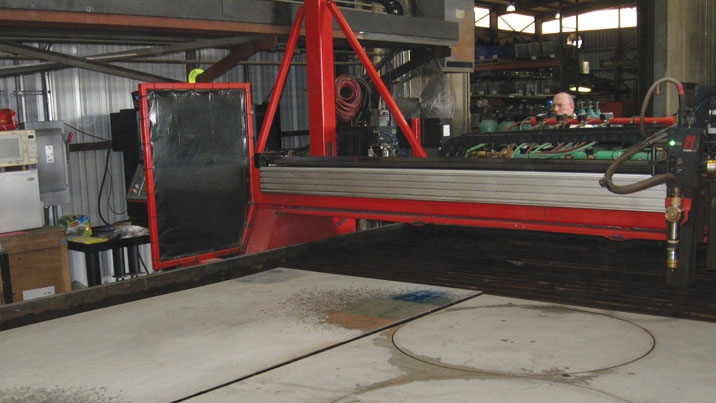

Mike Allen, Precision Flange and Machine’s president, leveraged his 30-year relationship with his authorized Hypertherm table manufacturer for help with the technology upgrade. Initially interested in rebuilding his existing cutting machine, Mike chose to purchase a new machine with enhanced motion capabilities and upgrade his cutting operation with a HyPerformance® Plasma HPR400XD® and ArcGlide Torch Height Control.
This combination of precise table motion with HyDefinition plasma cut quality and ArcGlide’s productivity improvements would augment Precision Flange and Machine’s existing product offering with multiple new thicknesses of parts to be cut on the same table. Additionally, the new system would relieve some of the cutting done by the company’s older PAC500 with three 601 power supplies, and operating costs would be lowered by maximizing production speed and consumable life.

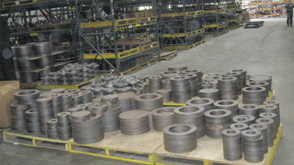

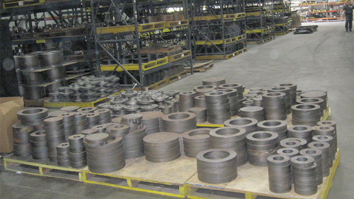

Precision Flange and Machine realized immediate benefits from the HPR400XD upgrade, including a significant improvement to cutting speed and quality. The HPR400XD delivers consistent cutting performance that requires almost no cleanup, enabling Precision Flange and Machinery to eliminate production steps from the cutting process.
“From one piece to 100 you get the same quality cut with almost no cleanup to speak of, so we have been able to eliminate other production steps. Our operator can take a lunch break and come back to the system still cutting quality parts.” – Mike Allen, President, Precision Flange and Machine
Other benefits include a 30% productivity improvement and the ability to bring more work back in-house for tighter quality control and lower costs. The HPR400XD can replace laser cutting for most applications, enabling Precision Flange and Machine to reduce outsourcing laser cutting by 80%.
We’re plasma cutting a majority of what was laser cut, with an 80% reduction in laser outsourcing, and we aren’t using oxyfuel as much.

Switching between jobs and materials is easy with the HPR400XD, so Precision Flange and Machine has significantly reduced downtime between jobs. The ability to instantly switch from gauge material to 2.5 inch stainless, in addition to the cut‑to‑cut cycle time enhancements of the ArcGlide, have enabled a more aggressive pursuit of new customers.
