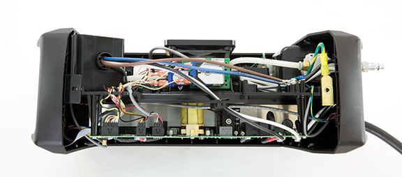

Typically higher quality systems – like Hypertherm’s Powermax® brand of plasma cutters – are designed with fewer parts, more robust components, and a design that separates sensitive components from metal dust that can cause premature wear. In other words, these systems are built to last and provide good value for your money. Cheap plasma cutters on the other hand use cheaper components that are nowhere near as robust as those found in higher quality systems.
If you were to remove the metal cover from one of Hypertherm’s Powermax plasma cutters you will quickly notice a couple of things. You’ll notice how empty the inside looks. There actually aren’t a lot of parts inside it. This is because the system is engineered using a methodology called Design for Manufacture and Assembly or DFMA. DFMA calls for engineers to identify, quantify, and eliminate waste or inefficiency in a product design. In addition, you’ll notice that the system has two sides, a clean side where the control board is located, and a dirty side where the fan is located.
Because there are so many cheap plasma cutters on the market, it is impossible to describe the inside of every single one of these systems. Generally though, the inside of these systems can resemble a birds nest with a tangle of parts and wires. Now, you might be thinking, “So what? Why does it matter what the inside of my plasma cutter looks like?” It matters because more parts means that you have more parts that can fail. And when a part does fail, it’s going to be much more difficult to fix because you’ll need to sort through a tangle of components to find the part that needs to be replaced.

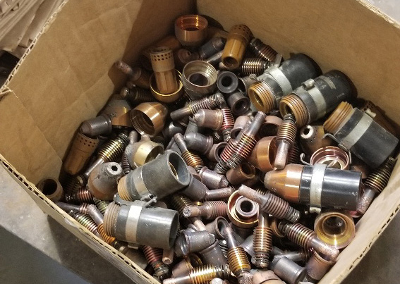

Another big difference between the cheaper plasma cutters and more expensive ones are the torch and consumables. Cheap, low-cost plasma cutters use older—in some cases 30-year-old—torch and consumable technology. If you were to look closely at the torches of the best cheap plasma cutters, you’d notice that they all look the same. The torches might have different colors, but the underlying design is the same. The torch and consumables on higher quality systems are engineered to work together with the plasma system it was designed for. They are tested with the power supply and optimized to work best with the power supply’s output characteristics. This is important because of the extremely high temperatures created when plasma cutting.
Unless you have a Powermax SYNC™ plasma or Hypertherm adapter that allows you to use a single-piece cartridge consumable, you will need to install the following five consumable parts onto the end of the plasma torch:
  • Electrode
  • Nozzle
  • Shield cap
  • Swirl ring
  • Retaining cap
Once your parts are on the torch, and you squeeze the trigger, an ionized gas arc will form between the electrode and nozzle. Energy is then added to that electrical arc to increase the temperature up to 13,871 degrees Celsius (25,000 degrees Fahrenheit.) After that, the arc is forced through a copper orifice to make the arc perfectly round and increase its velocity. The consumables you use need to withstand these hot temperatures without melting. Cheap consumables are cheap because they are not thoughtfully designed or carefully manufactured. They are not manufactured with the tolerances needed to ensure the consumables can withstand the extremely high temperatures caused by a plasma arc, and as such, wear out very quickly, typically after 120 to 250 starts. Consumables on more expensive, high-quality systems will withstand thousands of starts before needing to be replaced. Bottom line: Although cheap consumables cost less, they will cost you more in the long-run because you need to buy many more sets to equal the life of one good quality consumable set.
Consumable life-span is just the beginning though. You also need to consider cut quality. To do that, let’s explain how the arc impacts each of the five consumable parts. As mentioned earlier, when plasma cutting, you have a 13,871 degrees Celsius (25,000 degrees Fahrenheit) plasma arc passing through a tiny hole in a copper nozzle. Copper melts at about 593 degrees Celsius (1,100 degrees Fahrenheit) so high-quality torches are designed so the air flow that goes through the swirl ring and enters the inner chamber of the nozzle provides a unique and accurate gas swirl pattern. This acts as a centrifuge, slinging the cooler and heavier molecules of gas to the outside of the nozzle bore where they create a cool, nonconductive boundary layer that protects the copper nozzle from melting. There is an attempt to do this with the older technology torches, but it does not work nearly as well as a great deal of engineering expertise is required. In addition, higher-quality torches use a patented technology called conical flow technology. This technology cools the orifice exit and increases the arc energy density which results in a narrower, more concentrated arc and therefore better cut quality.
The electrode is another critical part. During steady state cutting the electrode emitter, which is a small slug of hafnium, remains in a molten state. When you release the trigger after a cut the post flow cooling air pulls a small slug of that molten hafnium and spits it out through the nozzle orifice. After 120 to 250 cycles with a cheap plasma cutter torch, most of this hafnium is gone. You’ll start seeing cuts with a lot more angularity and dross, and soon after that, a green flame emitting from the torch when the copper part of the electrode is consumed. High quality systems are designed to ramp the air pressure up and down and minimize thermal shock to the electrode when it goes from room temperature to 1,648 degrees Celsius (3,000 degrees Fahrenheit) at the beginning of a cut. If does something similar at the end of the cut. It ramps down at the trigger release so that the hafnium can re-solidify. Each power level and power supply / torch design require different microprocessor-controlled profiles, and that is one reason why torches and power supplies should be jointly designed by the same team of engineers. It helps to ensure longer consumable life and better cut quality.

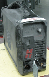

Heavily used systemNow, let’s talk about durability and reliability. Hypertherm’s Powermax systems are industrial machines designed to withstand harsh conditions and last for decades. When engineering a new system, alpha units undergo months of reliability testing. Technicians in our reliability labs modify the systems so the amperage is 10 percent higher than what the units are designed to withstand. These systems are then subjected to temperatures and humidity levels that are up to 30 percent higher than the design specifications. In addition, all of these units undergo a series of tests. We shake them, bake them, introduce large amounts of dust, and then drop them. All of these units are fired up and do actual plasma cutting under these conditions. Our technicians purposely stress these units until they fail. They then dissect the failure, re-engineer parts if needed, and return the unit to the testing chamber and repeat the same tests. These torture tests continue for upwards of 18 months until there are no more failures. This makes for long new product development cycles, but very reliable products.

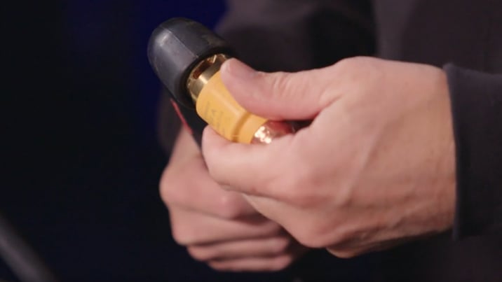

Someone changing a cartridge consumable
One last consideration you want to consider when out shopping for the best cheap plasma cutter is ease of service and part availability. You need to ask yourself how easy will it be to fix this system when something goes wrong. In most cases, you’ll discover a cheap plasma cutter is not easy or worth the money to fix. You are likely better off returning it if it’s still under warranty, or scrapping it and buying a new cheap system. As far as part availability, we are talking specifically about consumables. How easy will it be to find consumables for the system you buy? Does the manufacturer seem stable? Do you expect it will continue to manufacture consumables for your system? As an aside, Hypertherm guarantees it will support all of our plasma systems for at least seven years from the date a system is discontinued. Further, we often introduce retrofit torches and adapters that will allow owners of older systems to enjoy at least some of the benefits of our newest technology like the Hypertherm cartridge consumable shown above.
