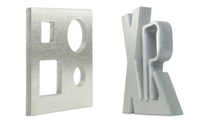

What kind of cut quality should I expect when plasma cutting aluminum?
Plasma cutting aluminum sample
Some people believe it is not a good idea to cut aluminum with plasma systems because its melting point is too low, making it difficult to get a nice, clean edge. While it is true that the melting point of aluminum is lower than most other metals, if you choose the correct gases and follow the parameters in your owner’s manual, you can get a very nice edge with tight tolerances (i.e., little angle variation) on both thick and thin aluminum. In addition, you should see very little dross.

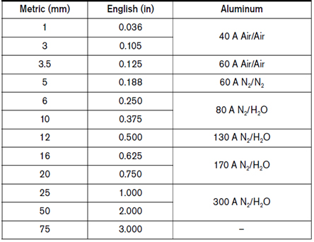

How can I achieve the best cut quality on aluminum?
No matter what material or thickness you’re cutting, our advice is always the same: Use the settings in the owner’s manual that came with your system. All of our manuals contain very detailed cut charts, including plasma cut charts for aluminum. Always start with the settings found in those charts. You can always make slight adjustments later if needed.

Aluminum less than 5 mm (0.188″) in thickness
When plasma cutting aluminum less than 5 mm (0.188″) in thickness, you will get the best cut quality if you use nitrogen as both the plasma and shield gas. Air is generally considered a good shield gas option because it provides adequate cut quality and a low operating cost.
To recap, when cutting aluminum less than 5 mm (0.188″) in thickness, we recommend using nitrogen as both your plasma and shield gas, referred to as an N2/N2 process.
Aluminum greater than 6 mm (1/4″) in thickness
When working with aluminum thicker than 6 mm (1/4″), we recommend using nitrogen as your plasma gas and water as your shield gas, so a nitrogen/water process. This combination provides excellent cut quality with a smooth surface finish, very good cut speeds, and the lowest operating cost.
If you need to cut aluminum that is thicker than 12 mm (1/2″), you can alternatively use H-35 or an H-2 mix as your plasma gas and nitrogen as the shield gas. These gases work especially well on material in excess of 20 mm (3/4″) where more energy is required.
