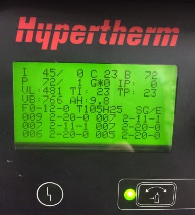

Getting to the service mode display is easy. Look at the front of your system and press the two buttons underneath the LCD display at the exact same time until you see the screen change. This should take about two seconds.
The photo below shows the service mode display/status screen. To find the live or active fault on this screen, look for the letter ‘F’ on the left, fifth-row down from the top. You’ll notice that the fault codes are longer. There is an additional dash and one more number added to the fault code’s length. A 0-12 can become a 0-12-0, 0-12-1, 0-12-2, or a 0-12-3.
Here's how to decode those numbers. If you see a zero at the end (0-12-0) then that tells you your input gas pressure is too low. You could see this even if you got a good input pressure reading earlier. If that’s the case, then the likely culprit is a bad pressure sensor. Test 10 in your service manual will help you figure out if you need to replace it. A one at the end (0-12-1) means your output pressure is too low. A two (0-12-2) means your output pressure it too high. A three (0-12-3) means your output pressure is all over the place, moving up and down.
