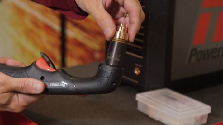

Once you have everything you need to begin, you are now ready to set everything up. Here is how to set up a plasma cutter.
Step 1: Install your consumables or Hypertherm cartridge consumable onto your torch.
Step 2: Depending on the handheld torch model, move the torch lock switch found on your plasma torch to the “on” position.
Step 3: Plug your torch and work lead (aka grounding cable) into the front of the power supply.
Step 4: Attach the clamp on the work lead to your work surface, taking care to not attach the clamp to the metal that will fall away after it is cut.
Step 5: Connect the gas hose to the back of the system.
Step 6: Plug in your power cord and turn on your system. The power switch on most Hypertherm plasma cutters can be found on the back of the system.

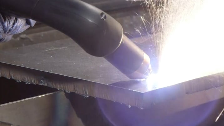

How to plasma cut, edge starting
Image edge starting
When using a handheld cutting torch, you can either start your cuts from the edge of the workpiece or you can start your cutting on the workpiece. Edge starting will provide you with longer consumable life. Here’s how to plasma cut when using an edge start.
Step 1: Select “cutting” using the mode control on the front of your system.
Step 2: Turn the amperage knob on the front of your system to the appropriate amperage for the thickness of metal you are cutting.
Note: If you have a Powermax SYNC® system you can skip both of the above steps since the system will automatically select the correct mode and amperage based on the cartridge you have installed.
Your owner’s manual contains cut charts that list a recommended amperage for a given thickness. Generally, to get the best cut quality and consumable life, you want to use a lower amperage for thinner metal and a higher amperage for thicker metal.
Step 3: Pick up and position your torch vertically just off the edge of the workpiece
If applicable, check to be sure your torch lock switch is off, then pull the trigger to initiate the plasma arc.
Step 4: Pause your torch on the edge of the workpiece until the arc has completely cut through the workpiece, then proceed with the cut by moving your torch at a steady speed.
Step 5: When you have completed most of the cut and are nearing the other edge, slightly tilt or angle your torch handle upwards so that the arc exits the workpiece first. This will ensure you get a complete cut.

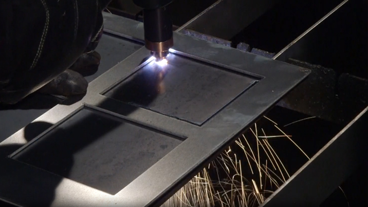

Though you can simply place your torch on the metal and cut free-hand, a torch cutting guide, straight edge, or template can help you to make more exact cuts. You can also use a circle cutting guide to cut out holes.

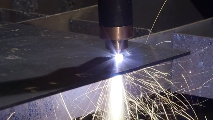

How to plasma cut, piercing thin material
Piercing thin metal
Though edge starting will provide you with the best consumable life, it is often necessary to start your cutting on the workpiece by piercing the workpiece. Here’s how to plasma cut when using the pierce method on thin material using a straight piercing technique.
Step 1: Hold your torch over the area you want to pierce.
Step 2: If applicable, check to be sure your torch lock switch is off, then pull the trigger to initiate the plasma arc and start your cutting.
How to plasma cut, piercing thick material
Piercing thick metal
Ideally, you should use a slightly different method when piercing thicker material. Here’s how to plasma cut when using the pierce method on thick material using a rolling piercing technique
Step 2: Tilt your torch so it is at a roughly 25-degree angle to the workpiece.
Step 3: If applicable, check to be sure your torch lock switch is off, then pull the trigger to initiate the plasma arc.
Step 4: Once cutting starts, rotate your torch to an upright position. Once the arc has pierced through the metal you can make your cut.

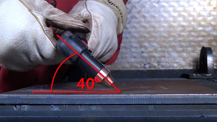

Step 4: Place the torch at an approximately 40-degree angle to the workpiece, holding a small gap between the torch and workpiece, press the trigger and then move the torch along the workpiece to create your gouge.
