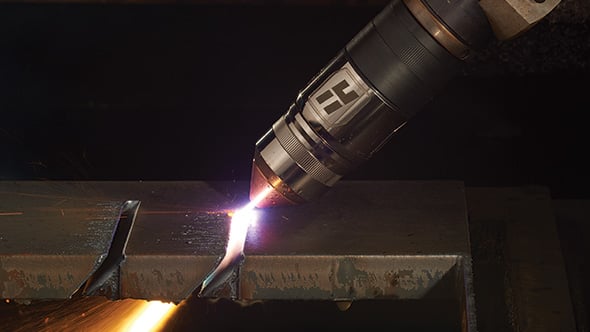

conventional plasma system in use (MAXPRO200)
Conventional plasma
Conventional plasma systems like Hypertherm’s MAXPRO200® are much larger than air plasma. How much larger? While air plasma systems are about the size of a microwave oven, conventional plasma systems are closer to the size of a kitchen stove. These systems typically use air, oxygen, or nitrogen for the plasma gas, and give you the option of using a second, different shield gas.
Price wise and performance wise, conventional plasma falls between our Powermax and high definition systems, which we’ll talk about next. You can cut faster and thicker material and will achieve slightly better cut quality than with a Powermax.
Some conventional plasma systems give you the option of using a handheld torch to cut metal by hand or a machine torch, used to cut material on a XY cutting table, pipe cutter, track cutter or something similar.
How much is a conventional plasma cutter?
Conventional plasma systems will generally range from approximately $15,000 to more than $20,000.
To learn more about conventional plasma cutting and which gas is right for you, we recommend you read our article on Guide to plasma gas selection.

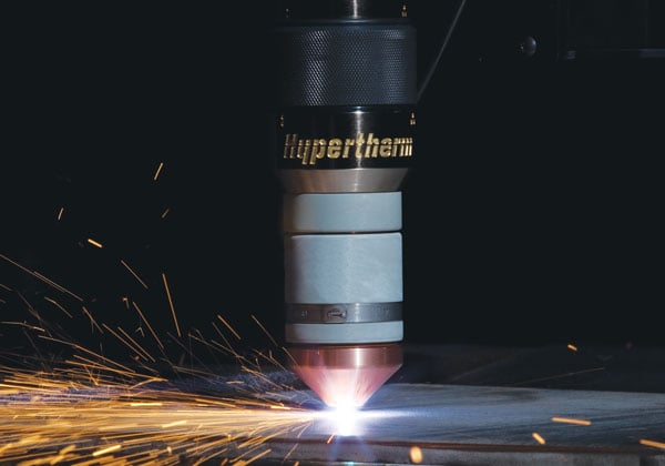

Image of XPR300 X-Def system in use
High-definition and X-Definition plasma
When answering the “How much is a plasma cutter?” question, high-definition and X-Definition plasma are at the top of the price range. First invented in the early nineties, high-definition plasma systems constrict the energy density of the plasma arc beyond that of conventional plasma. The end result is superior cut quality on materials up to 50 mm (2″) with excellent cut edge angularity, a narrower kerf, and higher cut speeds than conventional plasma cutting technology. It's not uncommon for these systems to achieve cut part accuracies within the +/- 0.25 mm (0.010″) range.
X-Definition plasma, the industry’s newest and most advanced plasma cutting technology, is capable of even better cut quality. When installed on a high-quality automated cutting machine, X-Definition plasma can deliver precision edge angularity that rivals laser with greater consistency. Cut speeds are also faster than other plasma types, while operating costs are lower.
Unlike air and conventional plasma, high-definition and X-Definition plasma systems are only designed for automated cutting with a machine torch, such as on a cutting table, beam line system, or a robot.
How much is a high-definition or X-Definition plasma system?
The costs for a high-definition or X-Definition plasma system can range from $50,000 to $65,000. It is important to note, however, that this cost is only for the plasma system. It does not include the cost of the cutting machine. Since high-definition and X-Definition systems are able to achieve exceptional cut quality and very fast cutting speeds, it is important that you choose a cutting machine with the appropriate motion capabilities for optimal cutting results.
