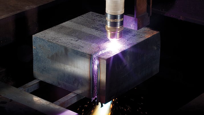

Using an edge start on thick metal requires proper positioning of the torch to allow the molten metal to carry down the majority of the thickness. Set the height of the torch to the cut height listed in the cut chart in the HPR800XD Instruction Manual.
  • Place the torch center line about 6 mm (0.25") from the edge of the workpiece.
  • An adequate motion delay must be used to allow enough time for the arc to melt the majority of the edge prior to motion being initiated. Refer to the HPR800XD Instruction Manual for suggested motion delays.
  • Use an initial cut speed of 75% of full cut speed for at least the first 25 mm (1") of the cut.
Special cornering considerations may be necessary when working with thick metal because of the extreme lag of the tail of the arc. If no technique is used, the cut edge may lose its form, especially near the bottom of the cut.
  • Rounding corners: Round off corners of 90 degrees or less. In general, the radius should be equal to or greater than the kerf value (larger is better).
  • Corner delay: Allow the motion to stop in the corner for approximately one second to allow the arc tail to catch up.
  • Corner slow-down: Approximately 25 mm (1") before entering the corner, slow the cut speed to 75% of full cut speed and maintain that speed for approximately 25 mm (1") after the corner.
Metal five or more inches thick requires special exiting techniques to avoid incompletely severing the part.
  • For cuts that involve the arc exiting the edge of the material, a cut speed of 75% of full cut speed should be used for the last 25 mm (1") of the cut. The cutting table must continue motion beyond the edge of the plate.
  • The dogleg lead-out technique (described below) can be used to redirect the tail of the arc and the molten metal flow into the remaining portion of the cut, allowing for a complete cut.
Dogleg lead-out
Proper lead-out for thick material is critical to completely sever a part. Without proper lead-out, a small tab may keep the part attached to the skeleton at the point where the lead-out enters the lead-in due to the extreme lagging tail of the arc. The dogleg method for stainless steel takes advantage of this lagging arc by focusing it onto the tab section of the cut.
  1. Follow the edge start, lead-in, and cornering recommendations outlined above.
  2. Cut the external contour of the part and approach lead-out.
  3. Just as the arc breaks through to kerf, change the cut direction by approximately 120 degrees into the skeleton at 115% of the cut speed.
  4. Continue the lead-out segment for approximately 32 mm (1.25"). The molten metal flow from cutting into the skeleton will melt the tab, completing the cut and allowing the part to drop.
