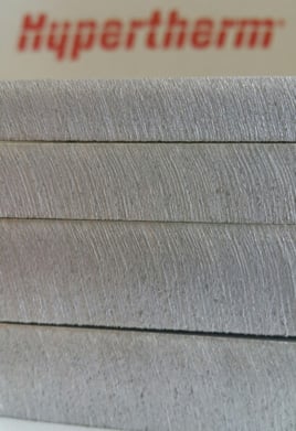

Another important factor to consider is cut quality. The XPR300 introduces a whole new class of cutting called X-Definition®. Advances such as Cool nozzle™, advanced arc stability, expanded HyDefinition® cutting on non-ferrous metals, Vented Water Injection™ (VWI), discrete gas mixing (H2, Ar, N2), Vent-to-shield and plasma dampening, in which a chamber in the nozzle absorbs pressure and flow fluctuations, have resulted in exceptional consistency in cut quality over a very long period of time.
Whereas the HyPerformance® Plasma HPR® systems achieved consistent ISO Range 4 cut quality for parts, the XPR300 achieves consistent ISO Range 3 cut quality and even ISO Range 2 on thinner material.

This greatly improved cut quality on mild steel, and more significantly stainless steel and aluminum, may enable fabricators to bring cutting previously outsourced to laser and other specialized cutting centers, in-house. This can lead to significant cost savings, an improved, more efficient supply chain (enabling JIT production,) faster delivery of jobs, and greater overall profitability.
