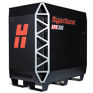

Though laser and plasma both cut metal using a thermal process, they work in very different ways. Regardless of type — CO2 or fiber — laser uses an intense, coherent beam of monochromatic light created by a stimulated emission of electromagnetic radiation. One of the advantages of a focused beam of light is that it can cut to extremely tight tolerances. There is less variability in the process. Generally, a laser can hold cut part dimensional tolerances of under 0.01" (0.25 mm).* Plasma on the other hand, uses a gas energized to the point of ionization to create a super concentrated arc that focusses energy at an extraordinarily high temperature. This results in cut part dimensional tolerances of roughly 0.02" (0.5 mm),* if using an X-Definition® capable plasma system.
There are tradeoffs to consider in part tolerancing and manufacturing process specifications and one of them is the cost driven by unnecessarily stringent requirements – the differences between laser and plasma tolerances as described above is only about the thickness of a common business card! So, before asking for “laser quality” or lobbying for laser equipment and facilities upgrades to accommodate the new equipment, you should ask yourself: “Do I really need these very tight tolerances on this part?”

  • The upfront cost of the machine tool that is required to deliver the tolerances. In the case of a laser versus an X-Definition, XPR®, plasma system, the differential investment cost can be many hundreds of thousands of dollars. Significant investments impact a company’s balance sheet and depreciation expenses.
