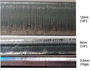

Cutting mild steel with a laser is balance of how much material is heated up with the laser beam and how much assist gas flows through the cut. Heating up too small of an area or not having enough assist gas flow through the cut will result in the kerf, (width of the cut) being too narrow. Heating up too large of an area or having too much assist gas flow through the cut will result in the kerf being too wide.

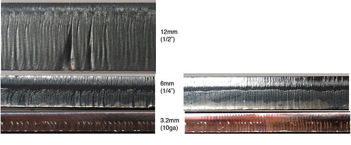

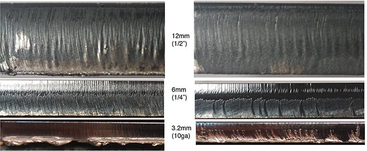

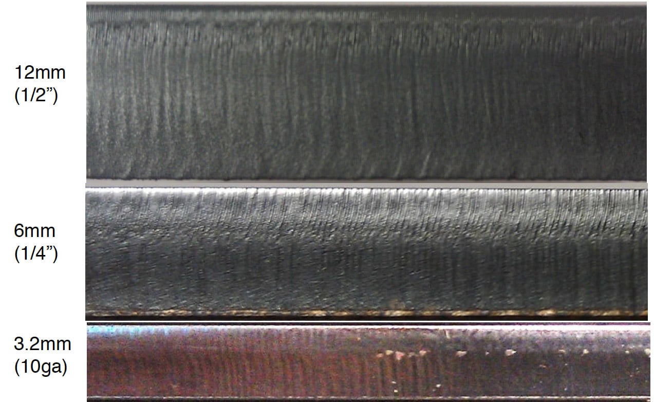

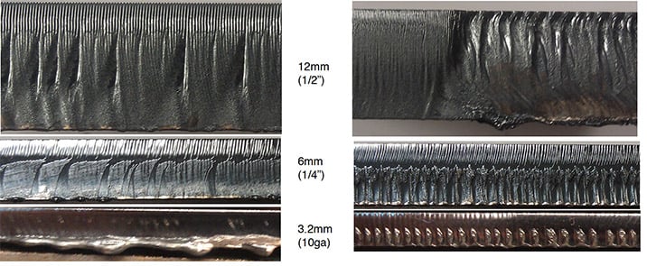

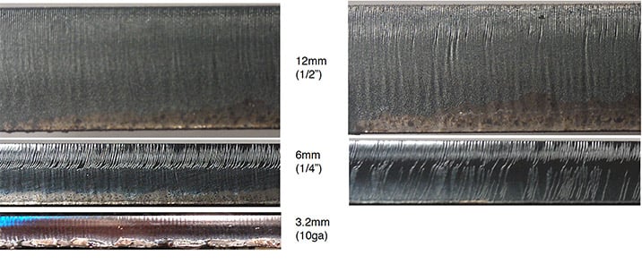

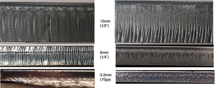

Below are examples of 12, 6, and 3.2mm (1/2”, 1/4”, and 10ga) mild steel cut with oxygen on a 2kw fiber laser and examples of the same part cut with 1 variable changed to show how it affected the cut quality. The examples of the adjustments made will be similar for any CO2 or fiber laser cutting mild steel with O2.
Factory cut chart settings
Kerf too narrow
Common characteristics would be a very smooth cut edge on the top, with a lack of oxidation on the bottom of the cut, and/or heavy dross.
Possible causes:
The focus is too low | The feedrate is too fast | |
The gas pressure is too low | The nozzle size is too small | |
The standoff is too low |
Kerf too wide
Common characteristics would be a rougher cut edge, more self burning in the corners of the part, more angularity on the cut edge, and occasionally dross.
Possible causes:
The focus is too high | The feedrate is too slow |
The gas pressure is too high | The nozzle size is too big |
The standoff, is too high | The nozzle type is incorrect |
