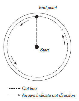

Step 1: Is the plasma arc cutting in the appropriate direction?
When CNC steel cutting, the most square cut edge angles are always to the right side, with respect to the forward motion of the torch.
  • Check the direction of the cut
  • Adjust the cutting direction by changing your plasma cutting settings, if needed
The plasma arc typically spins clockwise with standard consumables.
Contour:
  • Torch travels clockwise
  • Good side of the cut is to the right side of the torch, as it travels forward
Plasma cut: How torch travels
Internal feature (hole cutting):
  • Torch travels counterclockwise
  • The "good side" of the cut is to the right side of the torch, as it travels forward.
Plate with internal hole

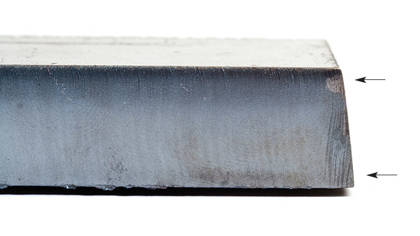

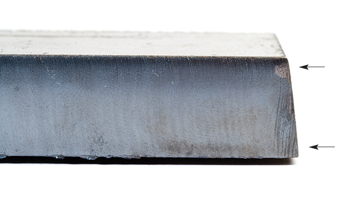

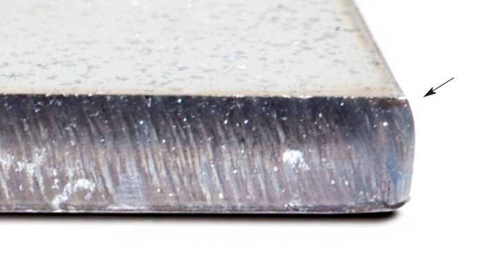

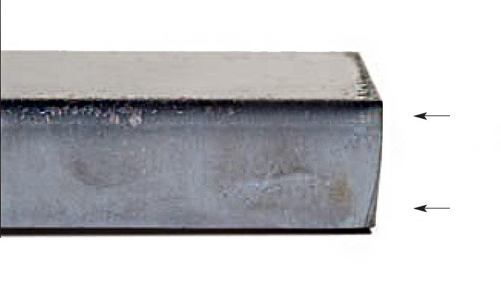

The torch-to-work distance can impact angularity
Negative cut angle: plasma torch too low; increase torch-to-work distance
Positive cut angle:
plasma torch too high; decrease torch-to-work distance
Note: A slight variation in cut angles may be normal, as long as it is within tolerance.

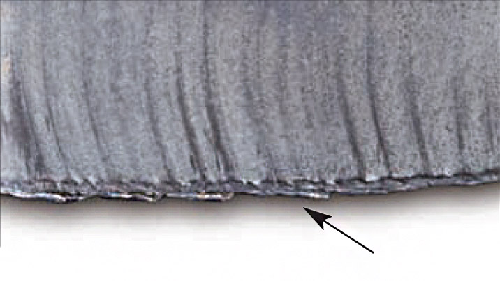

Step 6: Is the cutting speed set too fast or too slow?
  • Adjust cutting speed, as needed
Note: Cutting speed may also impact your dross or molten metal levels.

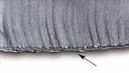

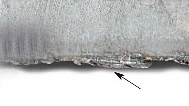

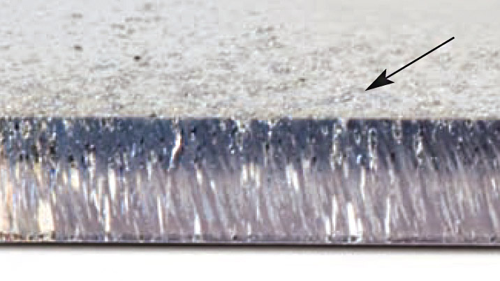

High-speed dross: Cutting speed too fast (arc lags behind), reduce cutting speed
Low-speed dross: Cutting speed too slow (arc shoots ahead), increase cutting speed
Top spatter: Cutting speed too fast, reduce cutting speed
Note: In addition to speed, both material chemistry and surface finish can impact the amount of molten material; as the workpiece heats up, more dross may form on subsequent cuts.
