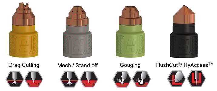

The Powermax SYNC systems do away with the five-piece consumable stack-up. Instead, all you need is a single-piece cartridge. You grab a cartridge, place it onto the torch, give it a quarter turn, and you’re done. It takes 10 seconds. Another convenient and foolproof aspect of Powermax SYNC is the color-coding. The cartridges are color-coded so you can be sure you’ve installed the right cartridge for the process you want to use. Instead of looking through a drawer for the parts you need, double checking to be sure you do indeed have the correct part numbers, putting your stack together in the right order, and then correctly assembling everything into the torch, you simply grab a color-coded cartridge and stick it on the SYNC torch. You are done!

The Powermax SYNC cartridge also delivers by lasting up to twice as long as a normal consumable stack-up when hand cutting, and providing improved cut quality for its entire life span when using a mechanized torch. Another benefit of the Powermax SYNC system is its ability to record usage data and transmit it using a simple RFID reader. It will track things like number of starts and arc-on time, helping you identify patterns and make your operation more efficient.
