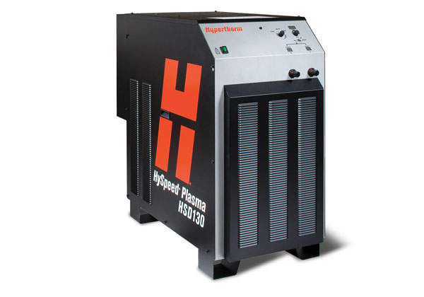

HySpeed plasma HSD130

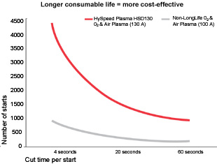

The HySpeed® Plasma HSD130™ is positioned between Powermax® air plasma and HyPerformance® HyDefinition® plasma systems. It features impressive cut speeds, rapid piercing and minimal secondary operations for maximum productivity. A cost-effective alternative to other metal cutting solutions such as oxyfuel or air plasma, the system incorporates Hypertherm’s patented LongLife™ technology to significantly improve consumable life for both oxygen and air processes.

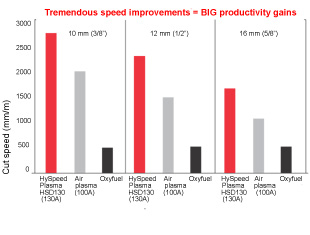

Speed* (Mild steel) |
Book specification at highest output current | 12 mm (1/2") 2200 mm/m (80 ipm) |

* Note: Take care in comparison: competitors often show maximum cutting speeds rather than speeds that deliver the best cuts, as shown above. Cut speeds listed above deliver best cut quality, but cut speeds can be up to 50% faster.
