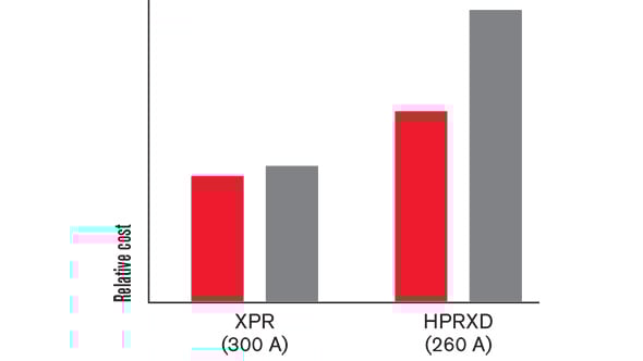

In summary, the combination of faster cut speeds, longer consumable life enhanced by ramp down error protection, improved cut quality and greater cutting consistency directly leads to lower operating costs and improved profitability. In fact, at 300 amps of output, the XPR300 can reduce the relative cost per meter or foot of cutting by more than 50 percent.
