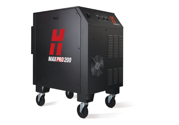

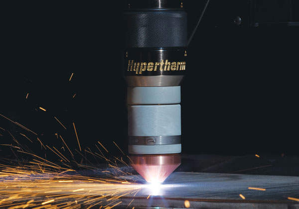

MAXPRO200 plasma cutter
The MAXPRO200® plasma cutter is engineered for heavy-duty, high-capacity automated and handheld cutting and gouging applications. The easy-to-use system operates with either air, oxygen, or nitrogen plasma gas, combining fast cutting speeds and quick process changes to maximize productivity. Advanced Hypertherm consumable designs – including LongLife® technology – improve cut consistency and significantly increase consumable life to lower your cost per part. Proven technology you can trust.
System information
Benefits
Maximized productivity
  • Fastest cut speeds in its class produce more finished parts per hour
  • Engineered with 100% duty cycle for the most demanding production environments.
  • Automatic settings, tool free leads and optional quick disconnect torches let you quickly transition between cutting, gouging, mechanized and handheld processes
  • Superior cut quality and consistency minimize the need for costly secondary operations
Fast cutting speeds = maximum productivity
Easy operation
  • Optimized cutting parameters are automatically set and controlled in one step to deliver consistent results without operator intervention
  • Advanced diagnostics simplify troubleshooting and service
  • Optional serial communications allow full control of the system from the CNC
Low operating cost
  • Patented consumable designs enable best in class cut speeds and robust production piercing using lower amperage levels
  • Advanced consumable technologies including LongLife, CoolFlow™ and TrueFlow™ significantly increase consumable life to reduce cost per part
MAXPro200 - Longer consumable life = more cost effective; 12 mm (1/2") mild steel - 200 A Air/Air
Industry-leading reliability
  • Robust, simple system architecture with 50% fewer parts than most competitive systems
  • Best-in-class manufacturing and extensive testing ensure that every Hypertherm system meets the highest quality standards
