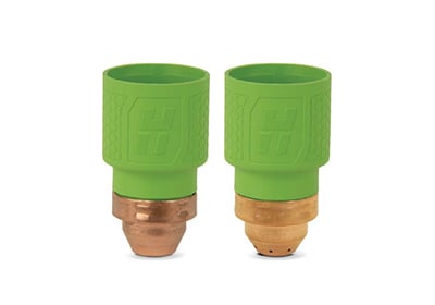

First, choose and install the correct gouging cartridge. As mentioned above, all of our gouging cartridges are green. We make four different cartridge types designed for different gouging profiles and amperages.
Max removal cartridges are designed for removing lots of metal. Use these to create deep and / or wide gouges.
Max control cartridges, as you might guess from the name, offer you more control. These are good for removing small amounts of metal including spot welds. If you are new to gouging, we recommend that you start with these.
Gouging cartridge types

Although you can use our gouging cartridges with either a handheld torch or on a machine, such as a CNC table or track burner, this article will only focus on the technique for handheld gouging.
